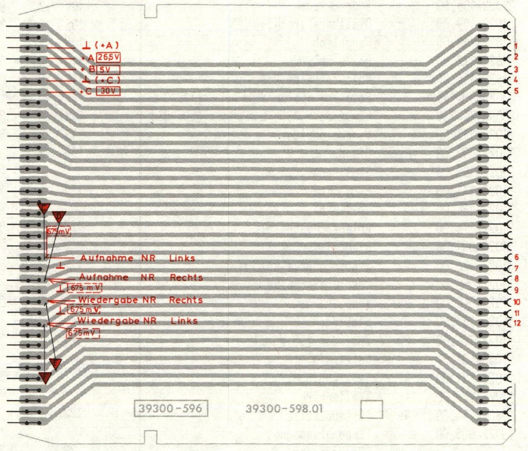

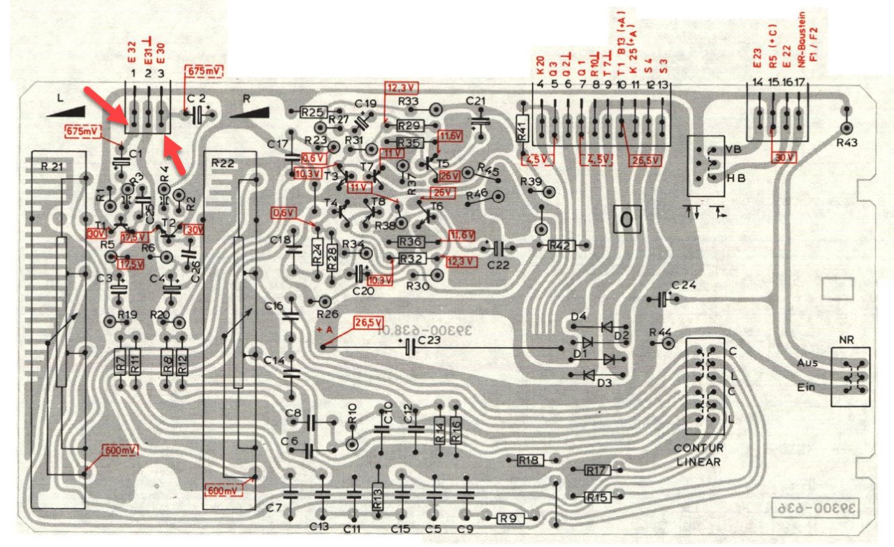

Ok, if you playback the testtape, you have to adjust the internal level to 675mV (with this 250nWb tape) @9,5cm/sec
The internal level you can measure at the adpapter board
or on the input plug for the phones amplifier
Or the output from the monitor socket. If you do so, you have to put the output gain poti to maximum.
You have to adjust the internal level with gr53/gr54 on board G to 675mV.
After that adjust the VU Meters with GR61/GR62 on board D to -6dB, what corresponds to 514nWb@0dB
...that's it
