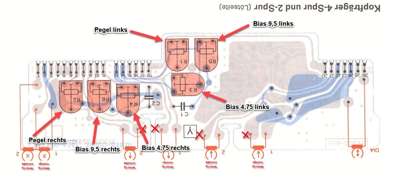

Hi Mampfi,
Still waiting for my level test tape.
In the meantime, could you explain the role of R1/R3/R5 and R2/R4/R6 trimmers on board Y for recording ?
Thanks in advance.
Regards.
François
Beiträge: 1904
Re: Record and playback calibration
First of all you have to adjust the recording azimuth to the playback head. In hope the playback azimuth is correct.
Because you need a azimuth testtape to adjust it. Give a 10kHz -20dB signal to the machine and measure it with oszillograph.
Set the sinus curves on top of each other on the screen, so you can see if the sinus curves matches each other.
If you do so, you can adjust the recording level and the pre magnetisation for 19cm and 4,75cm speed.
Choose a type of recording material that you like. LPR35 or something like that.
Put a 1kHz Signal to the machine and record it with 19cm @ 0dB ---> approx. 1,3V at the output from the monitor socket.
Turn the prerecording/recording switch to record and adjust R1/R2 that you have the same level in prerecording and in recording position.
Don't move the recording slider/controller. Put a -20db Signal with 10kHz into the machine and switch also from prerecording to recording.
Adjust R5/R6 so that you have the same level between prerecording and recording.
Do the same with R3/R4 @ 4,75cm
Note:
The recording level @0dB will be adjusted only once @ 19cm or 9,5cm/sec
Grundig wrote to do so @9,5cm. I do this @ 19cm/sec. and optimate the frequency response for 19cm/sec
There is only one adjustment for 9,5 and 19cm/sec
You can use R5/R6 and R3/R4 to optimate the frequency response

Beiträge: 1904
Sorry for the late news. We were out for a short Holiday.
Yes i think you have to align the trimmers like i described in my earlier post.
1. First use 1khz @ 0db to get no difference between record and playback.
2. Then use 10kHz @ -20dB to get no differnce between record and playback.
If you do so, repeat step 1 and 2 until you have (almost) no difference for both alignments.
Because the results influence each other somewhat
Use R1/R2 on Y board to calibrate the 1khz level.
Use R5/R6 on Y board to calibrate the 10kHz level for 9,5/19cm speed
Use R3/R4 on Y board to calibrate the 10kHz level for 4,75cm speed

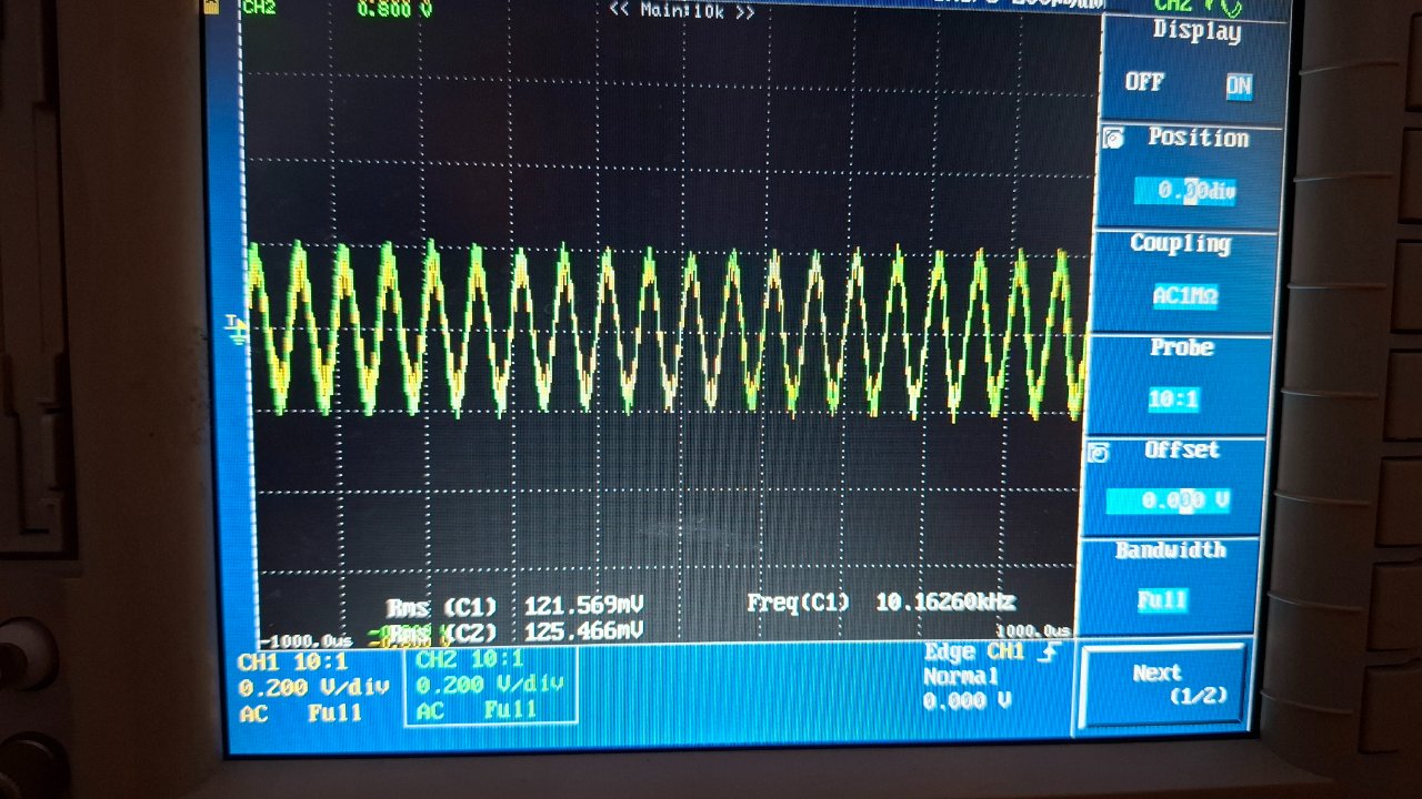

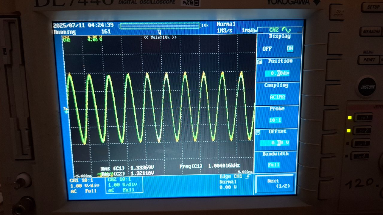

frpe12
Beiträge: 23
Registriert: Fr 11. Apr 2025, 07:17
Beitrag von frpe12 »
Hi Mampfi !
Job done !
Many many thanks for your support.
The tuning you described works perfectly.
You can check my screenshots attached.
Calibration and heads alignment are now OK at 1khz and 10khz.
Let's enjoy !
With kind regards.
Francois
10khz at -20db with 19cm/s
1khz at 0db with 19cm/s
