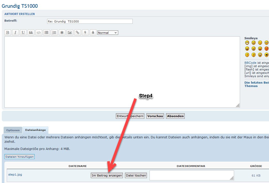

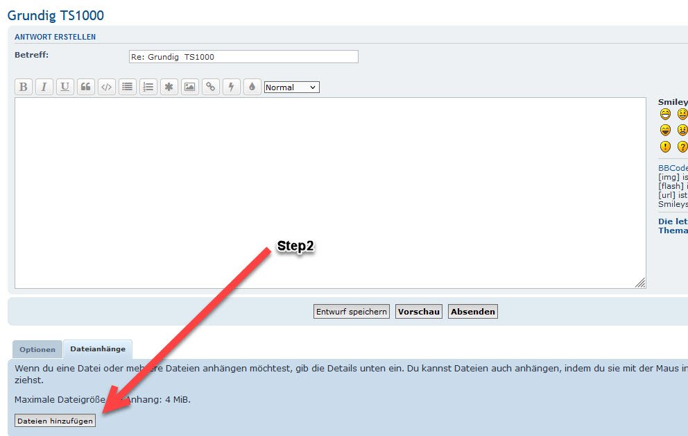

How to add a photo
Step1 ..... Step2 Step3 find a picture of your choice in your computer
Step4 make your choice with the vertikal line on wich you want to insert the picture
