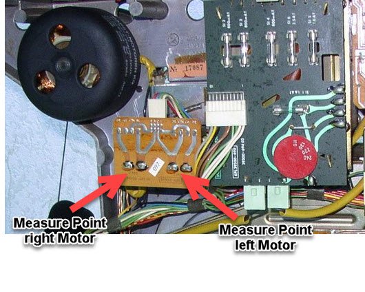

Dear Mamphi, you have a lot of patience and I appreciate that. I have a bad serv.manual and I cannot see how the 2/2.5 mm could be set. The only possibility to adjust anything is the switch above the lever. The voltages you measured is that on the tabs of c101 and c102?
Beiträge: 1907
Re: Grundig TS1000
Hello Willem,
ok let's try in English. First of all you can get the TS 1000 Service Manual in very good quality here in the download section. The size is over 63MB, so the quality is pretty fine. All the details for basic mechanical adjustments you can find on side #6.
I made a picture from the measure points for motor voltages.
Hope this details may help you.
